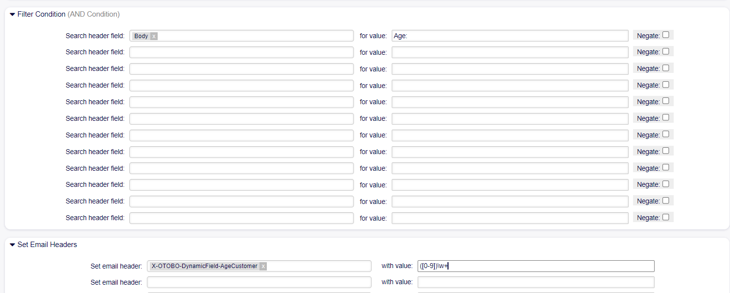

        When use Regex, Otobo understand it as a „string“ not Regex ( Image below). Did anyone test this or do we have any option to use?

          You need to use the regex in the search field and use the result in the set field.
          Search header field: Body
          for value: Age:\s*(?<age>0-9)+
          Set email header: X-OTOBO-DynamicField-AgeCustomer
          with value: [**\age**]

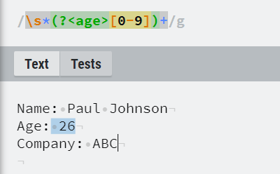

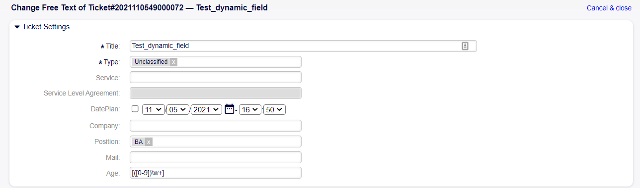

              I use regex formula as you said but OTOBO only filter only 1 digit. I checked with Regex Online, it success filter only Digits but not fully success in my OTOBO (Image below). I wonder if my system wrong or something else need to check?

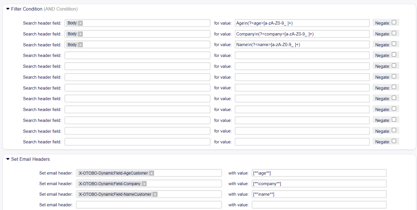

              One question: – Does the search condition have to be at same line?  From me, for each value I have 2 lines. I try to use regex but it not work. Testing in regex online is work but not correct in OTOBO.
              Result

              Renée Bäcker
                Replace „\n“ with „\s+“:
                Age\s+(?<age>...

                phuoc-nguyen
                  Thank you.
                  Everything is working as expected.
