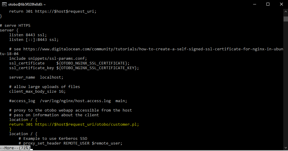

                I have tryed but it doesn’t work fine.
                I have added but nothing
                Thank You
              • 28. September 2021 um 22:39 Uhr #11966
                bes
                  Hi Giordiano,
                  from the screenshots I gather that you have created a volume and that you have adapted the custom config file. Did you also adapt the file .env ? If yes, you can check your Nginx container.
                  bes:~/devel/OTOBO/otobo-docker (rel-10_0)$ docker exec -it otobo_nginx_1 bash
                  root@e1ce50e91562:/etc/nginx# more /etc/nginx/config/template-custom/otobo_nginx.conf.template
                  more: stat of /etc/nginx/config/template-custom/otobo_nginx.conf.template failed: No such file or directory
                  root@e1ce50e91562:/etc/nginx# exit
                  exit
                  In my installation I don’t have a custom config installed. But you should see your adapted config. If the custom config looks fine and the redirect still does not work you can try first to restart the container.
                  docker-compose restart nginx
                  Good luck,
                  Bernhard

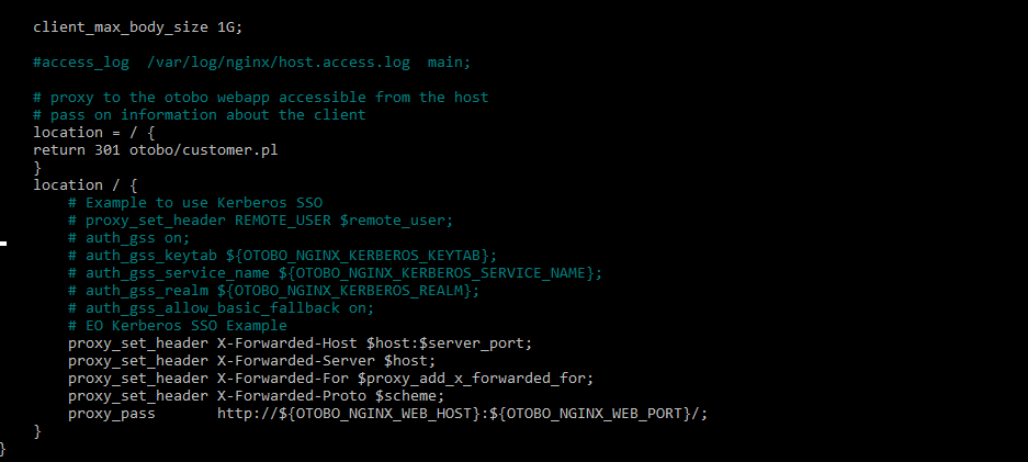

                    You can see my configuration…
                    I have tryed restart nginx service, but it doesn’t work fine…:-(
                  • 29. September 2021 um 10:30 Uhr #11968
                    bes
                      Hi Giordiano,
                      one  thing I noticed in your config is that the redirect is set up for a prefix match on ‚/‘. It propably should be an exact match as set up by location = / { ... }.
                      Also I’m not sure how the problem manifests itself. Is nginx not starting up? Or is only the redirect not working? Are there error messages in the nginx log. The log can be inspected with docker-compose logs nginx.

                    • 29. September 2021 um 10:52 Uhr #11969
                        Only redirect isn’t working.
                        I have corrected in location.

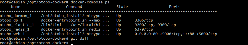

                            bes
                              Now I’m confused. The service web is obviously running, but nginx isn’t. The .env file with
                              COMPOSE_FILE=docker-compose/otobo-base.yml:docker-compose/otobo-override-https.yml:docker-compose/otobo-nginx-custom-config.yml
                              looks ok too.
                              Do you have other changes that might break things? What does git diff say? What does  docker-compose ps say?
                            • 29. September 2021 um 16:55 Uhr #11977
                                I haven’t changed anything….
                              • 29. September 2021 um 17:47 Uhr #11978
                                bes

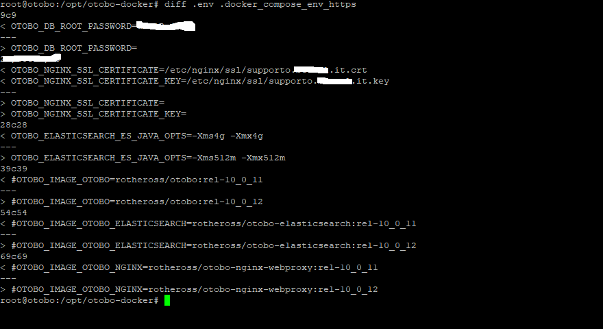

                                  OK, we are getting closer. The service nginx is not running. This means that access via https://localhost/otobo/index.pl should not work. I just saw that in your first mail you mention http://www.supporto.XXXXX.it. But  because you mentioned nginx I just assumed that you are running with SSL support.
                                  The first question is whether you need, or want, SSL support. Both scenarios are supported.
                                  1. SSL support is wanted: your .env file seems to be strange. Could you run  diff .env .docker_compose_env_https and mask out the sensitive parts?
                                  2. SSL support is not wanted: nginx is not needed at all. Replace ‚otobo/index.pl‘ with ‚otobo/customer.pl‘ around line 445 in the file /opt/otobo/bin/psgi-bin/otobo.psgi which is available in the container web. As a sanitiy check you can also do a diff .env .docker_compose_env_http
                                  In one of the next releases of OTOBO we plan to make this much more simple. See https://github.com/RotherOSS/otobo/issues/1279.
                                • 30. September 2021 um 10:27 Uhr #11982
                                    Good Morning Bes,
                                    yes I have two otobo, one is VM localhost for testing other is production version.
                                    In production version we have SSL and I configure it with default https template.
                                  • 30. September 2021 um 12:53 Uhr #11983
                                    bes
                                      Hello Giordano,
                                      this clarifies things. As you are not using SSL in your test installation, you are also not using nginx there. Subsequently, any changes to the nginx config won’t have any effect.
                                      It makes perfect sense to test config changes first in the test system. This can be achieved by using nginx in the test system as well. This can be achieved by basing the .env in your test system on .docker_compose_env_https and to activate a custom nginx config. You can choose whether you want to add certificates to your test installation. The alternative would be to change the listen directives in  otobo_nginx.conf.template in order to support only HTTP.
                                      Best regards,
                                      Bernhard
