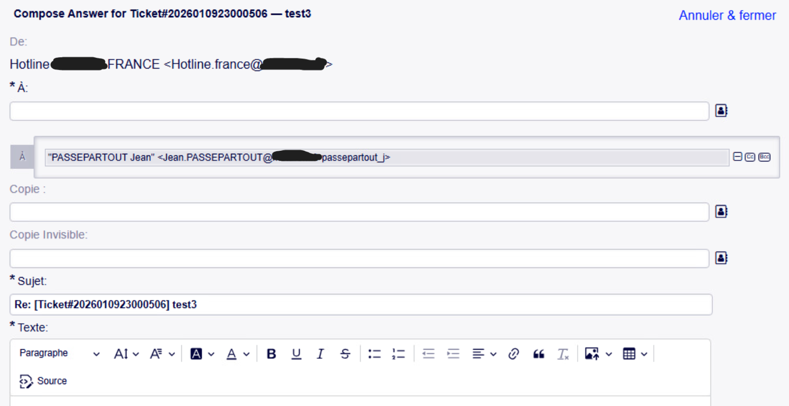

                            Hello, I have a new problem. I managed to set up LDAP, but in Otobo, when I wanted to reply to a ticket, it gave me the email address + the SAMAccount, so it doesn’t work because the email address is required in the reply. How can I fix this error? Thank you.
                          • 14. Januar 2026 um 10:28 Uhr #38712
                            Raphael Riquet
                              <exemple : raphael@blabla.com riquet-raphael>

                                    • 14. Januar 2026 um 15:02 Uhr #38739
                                      Raphael Riquet
                                        As seen in the image, there is a ticket to create, and when I want to reply to it, it doesn’t work because we see the LDAP username passepartout_j. And I can’t find the i.
                                      • 14. Januar 2026 um 15:31 Uhr #38740

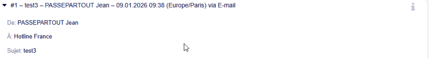

                                          That is the response mask.
                                          What is the sender of the article you are replying to?
                                        • 14. Januar 2026 um 15:36 Uhr #38742
                                          Raphael Riquet
                                            This is the window for responding to a ticket.
                                            The user sent us a ticket by email, and we received it on Otobo. The image shows when we responded > empty response.
                                          • 15. Januar 2026 um 9:00 Uhr #38751
                                              Right. But what is the email address of the user that sent the email that created the ticket. What does OTOBO show in the article (the email that created the ticket)? Please inspect the sender of the article you are responding to (Icon of an i in the top right of the article and then hover the entry in the from field).
                                            • 15. Januar 2026 um 10:05 Uhr #38754

                                              • 15. Januar 2026 um 12:24 Uhr #38763
                                                  Nice. Now hover the mouse cursor over the sender and you will see what otobo parsed from the email.
                                                • 15. Januar 2026 um 12:41 Uhr #38764
                                                  Raphael Riquet
                                                    When I hover my mouse over it, I can see the email address, but the problem is that when I reply, it automatically puts the LDAP ID in. So it doesn’t work and we can’t reply to the ticket.
                                                  • 15. Januar 2026 um 12:56 Uhr #38766
                                                      But the ID is not part of the email as depicted in the sender of the article you are replying to?
                                                    • 15. Januar 2026 um 12:59 Uhr #38767

                                                          • 16. Januar 2026 um 10:21 Uhr #38798
                                                              Thanks for the code. However, it does not include CustomerUserListFields.
                                                              It should be set like:
                                                              CustomerUserListFields => ['cn', 'mail'],
                                                              or
                                                              CustomerUserListFields => ['givenname', 'sn', 'mail'],
                                                              always with mail as the last property.
                                                            • 16. Januar 2026 um 15:47 Uhr #38818
