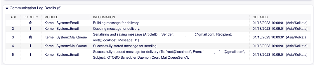

        Dear All,
        I have setup Otobo Docker Installation Version:10.1.1 with the help of:
        https://computingforgeeks.com/how-to-install-otrs-ticketing-system-on-ubuntu/
        where I am unable to send emails via Postfix GMAIL SMTP Relay though Otobo SMTPS though I can send emails through Ubuntu CLI. Fetch mail and Fetch MailSSL are disabled. I can receive the emails on Postmaster account and users are able to raise ticket by themselves as well. Users are not getting forgot password emails and the password email during signup. Below-mentioned is the error log which I can see in communication logs.
        Communication Log Details (5)
        Kernel::System::Email
        Building message for delivery.
        Queuing message for delivery.
        Kernel::System::MailQueue
        Serializing and saving message (ArticleID: , Sender: myuser@gmail.com, Recipient: root@localhost, MessageID: )
        Successfully stored message for sending.
        Successfully queued message for delivery (To: ‚root@localhost‘, From: ‚myuser@gmail.com‘, Subject: ‚OTOBO Scheduler Daemon Cron: MailQueueSend‘).
        The problem is with the SMTP process only.

            • 22. März 2023 um 15:23 Uhr #14970
              kps
                Hi Abhishek,
                in my test installation the requests went out to google. however, i get a „Bad Credentials“ error back. Google does not support the login of „less secure apps“ anymore and so there is no chance to use google at the moment.
                https://support.google.com/accounts/answer/6010255?hl=en
                For this oauth2 would have to be implemented for sending emails. For this you could write once to hallo@otobo.de and ask for an effort estimate.
                Otherwise you have to try to create a relay server to which OTOBO sends the mails and then they are forwarded to google.
                i hope i could help you a little bit, best regards,
