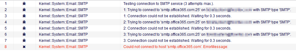

        Hello everyone,
        ive run into a problem concerning the integration of O365.
        Im running OTOBO as a Docker, Version 10.
        When trying to send a Email via OTOBO the following Message appears.
        On the Firewall there is no Problem.
        The Email-Address an Password are both correct.
        Ive also tried using SMTPTLS:587, same thing.
        Any ideas?
        Thanks.

          Couple of thing you can try to figure out what is wrong:
          • attach to the running web docker and check the logs shown on the console using command: docker attach otobo_web_1
          • connect to the webserver docker using bash and check by using telnet if connection works to the office 365 servers from there using command: exec -it otobo_web_1 /bin/bash
          • check dns settings if the office 365 server is reachable or use ping and telnet etc from the bash console stated above.
          ps, use the docker commands from within the /opt/otobo folder otherwise it won’t work
          if something comes up, update the forum ticket ;-)
        • 31. Juli 2021 um 12:37 Uhr #11786
          A. Flora
            one other thing, did you allow external connections in office 365 ? i believe you need to set something on office365 to allow smtp connections from external sources. Maybe check google on this one.

              Hi again,
              i was able to ping smtp.office365.com but the /opt/otobo folder doesnt exist on my otobo docker, therefore i cant try out the commands you recommended.
              Am I doing something wrong?

                      yes it’s possible to use a own mailserver on OTOBO side, but it’s definitely possible to connect to O365, I have already connected several systems to it without problems.
                      Lukas, on a docker system you need to change first inside the container, then you are already in /opt/otobo:
                      docker> docker exec -it otobo_web_1 bash
                      Now please check if O365 is really reliable:
                      telnet smtp.office365.com 587 (or test the other smtp ports like 25)
                      Default setting in O365 is SMTPTLS, not insecure SMTP.
                      If Office365 and the SMTP Settings in OTOBO is configured correctly, it works.

                        The Problem was that the Otobo-docker was initially set up as HTTP.
                        I reconfigured it that when it started working.
