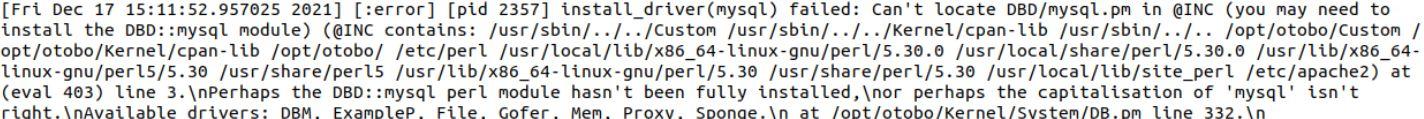

        So here is my problem…at first i configured my apache webserver – all good – until on the index page i got the failure „otobo@localhost failed to login using password „YES“ “ so i googled this thing and came to the mastermind conclusion that i need to reinstall my mysql server. So now it got really funny.. as i reinstalled the mysql server i got an Internal Server Error my apache log means this  Failure

          Hi Paul,
          I don’t know why you installed your database again, cause I’m sure that’s not the solution (did you execute https://yourFQDN/otobo/installer.pl as described in the install tutorial?).
          Now you miss some modules, so please execute:
          root> su – otobo
          otobo> bin/otobo.CheckModules.pl –inst
          and install all needed modules.

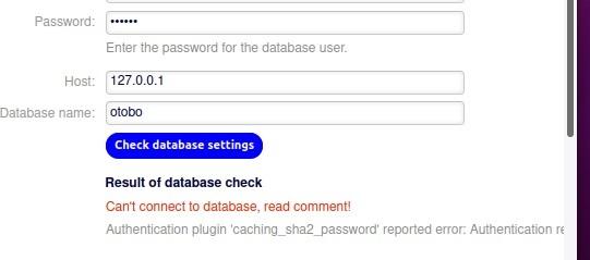

            thanks for the advice, i’m right now executing the installer.pl but i ran to another problem…
            It requires a secure connection?
            Best Regards,
            Paul

              Hi Paul,
              please follow the installation manual step by step. You need to have a look to the database chapter:
              After installing the MySQL server you need configure it.
              In MySQL higher or equal version 5.7 a new authentication module is active, and it is not possible to use the OTOBO web installer for database creation. Please login to the mysql console and set a different authentication module and password for the user root if this is the case.
              Please change the authentication module and restart the installer.pl
