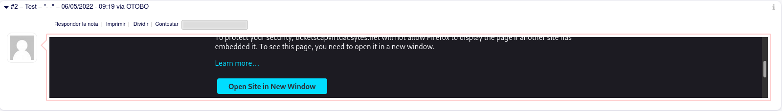

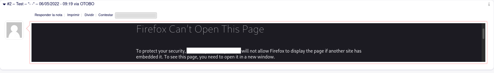

        I have a problem with a new installation of OTOBO, the notes are showing like this:

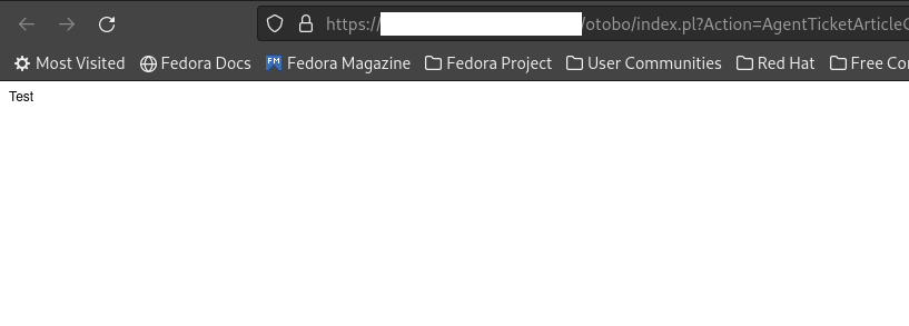

        If I click on „Open Site in New Window“ button the contents of the note displays correctly in a new window as shown in the picture

              I found the issue.
              Part of the configuration that used to do when I configure OTRS was add a config file on /etc/apache2/conf-available and add some parameters, here is my file.
              SSLCipherSuite EECDH+AESGCM:EDH+AESGCM
              SSLProtocol -all +TLSv1.3 +TLSv1.2
              SSLOpenSSLConfCmd Curves X25519:secp521r1:secp384r1:prime256v1
              SSLHonorCipherOrder On
              Header always set Strict-Transport-Security „max-age=63072000; includeSubDomains; preload“
              Header always set X-Frame-Options DENY
              Header always set X-Content-Type-Options nosniff
              SSLCompression off
              SSLUseStapling on
              SSLStaplingCache „shmcb:logs/stapling-cache(150000)“
              SSLSessionTickets Off
              SSLOpenSSLConfCmd DHParameters „/etc/ssl/certs/dhparam.pem“
              The issue was on Header always set X-Frame-Options DENY, that DENY option was causing a problem rendering the <iframe> where the note displays so I changed to Header always set X-Frame-Options SAMEORIGIN and the problem was fixed.
