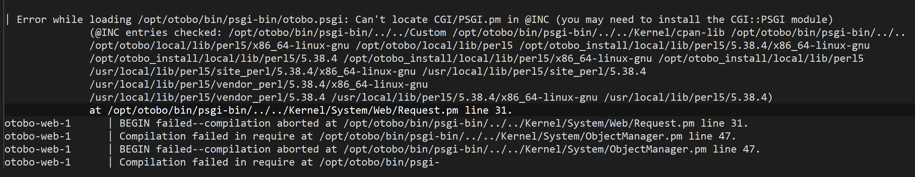

        Installing a vanila otobo docker V11.0_11 does not start the otobo web docker  and otobo-web docker is in a restart loop
        steps taken:
        git clone https://github.com/RotherOSS/otobo-docker.git –branch rel-11_0_11 –single-branch
        cp .docker_compose_env_http to .env
        add db root password to .env
        starting the with
        docker compose up
        the error reported in the log files:
        error web log
        Has anybody has seen this behaviour?

          yes, after upgrading Ubuntu from 22.04 to 24.04 we encountered the same issue.
          The resolution was to install the missing Perl module via CPAN:
          sudo cpan CGI::PSGI

            something must have went astray with your installation. In OTOBO 11.0.x CGI::PSGI is no longer contained in the Docker image as OTOBO no longer uses CGI::PSGI. See https://github.com/RotherOSS/otobo/issues/1683 .
            I recommend that you start over with your installation and make sure that the /opt/otobo volume does not contain data from a previous OTOBO 10.1.x installation.

              The error is reported in then otobo docker downloaded with
              Should the package CGI::PSGI not just be part of the docker image?
              isn’t running otobo docker already the clean installation and contained piece of Otobo? Can you please elaborate on what you mean exaclty with a clean installation when using the otobo docker image?

                i tried to state that OTOBO 11.0.x no longer uses CGI::PSGI. So there is no reason to include that Perl module in the Docker image. But you do get an error message about CGI::PSGI from presumably /opt/otobo/bin/psgi-bin/otobo.psgi. Therefore I conclude that your otobo.psgi is not really the otobo.psgi from OTOBO 11.0.x.
                otobo@a477b2a5f181:~$ pwd
                /opt/otobo
                otobo@a477b2a5f181:~$ grep VERSION RELEASE
                VERSION = 11.0.x
                otobo@a477b2a5f181:~$ grep -r CGI::PSGI
                Kernel/GenericInterface/Transport/HTTP/REST.pm: # Attention: CGI::PSGI and CGI use all-uppercase names for headers.
                Kernel/GenericInterface/Transport/HTTP/SOAP.pm: # the CGI::PSGI object already has the POST of GET content
                Kernel/GenericInterface/Transport/HTTP/SOAP.pm: # The Perl module CGI::PSGI takes the setting and
                Kernel/GenericInterface/Transport/HTTP/SOAP.pm: # Attention: CGI::PSGI and CGI use all-uppercase names for headers.
                scripts/test/GenericInterface/Transport/HTTP/REST.t: # Keys were uppercase by CGI::PSGI in nph-genericinterface.pl
                scripts/test/GenericInterface/Transport/HTTP/SOAP.t: # Keys were uppercase by CGI::PSGI in nph-genericinterface.pl
                CHANGES.md:- 2023-01-13 16:32:49 +0100 [Tidied] Use Plack::Request instead of CGI::PSGI (https://github.com/RotherOSS/otobo/issues/1683)
                CHANGES.md:- 2021-05-26 19:02:03 +0200 [Bugfix] CGI::PSGI->EnvQueryString() returns an empty string (https://github.com/RotherOSS/otobo/issues/1027)
